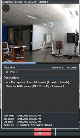

Able to Create an event with API : https://localhost:443/api/rest/v1/events. I can see the bookmark, However how to see the metadata which I am sending ?
Able to Create an event with API : https://localhost:443/api/rest/v1/events. I can see the bookmark, However how to see the metadata which I am sending in the bookmark?

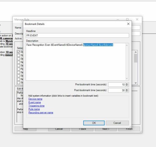

Yes I am creating the bookmark on event rule. How can i expand to include events metadata while defining the bookmark ?

In this metadata , I would like to show location and confidence in the bookmark.
The automatic creation of bookmarks using a rule does not allow transfer of data from the event to the bookmark.
You could instead send both an event and bookmark, in that way you can make sure the bookmark includes some extra text.
