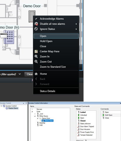

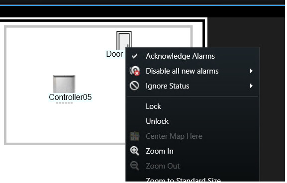

I just finished an Access Control plugin, but I don’t see the .png icons in the Smart Client right-click menu commands. They appear correctly in the Management Client. Is this a bug?
It is not a bug, the Demo Access sample does the same. Please see below picture from Demo Access sample on Smart Client. As you can see, there is no icon on the menu.

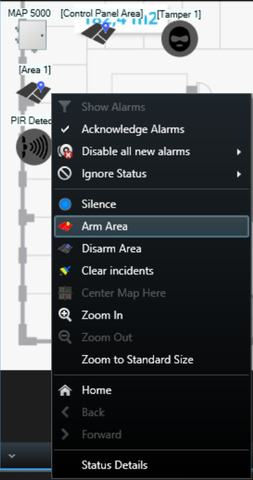

It’s possible to have command icons for other plugins. I think you should add the Access Control icons back in, they have their importantance.
Here is an example for MAP5000 instrusion plugin we did with command icons:

As you have seen, AC plugin has not implemented showing icons for the commands related to the AC elements, despite other plugins have them. We strongly agree that they have their importance for a good UX experience.
Besides, as Rie mentions this is not a bug, thus, this feature request is now included in our backlog.
