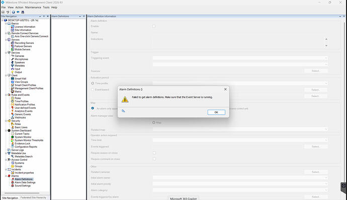

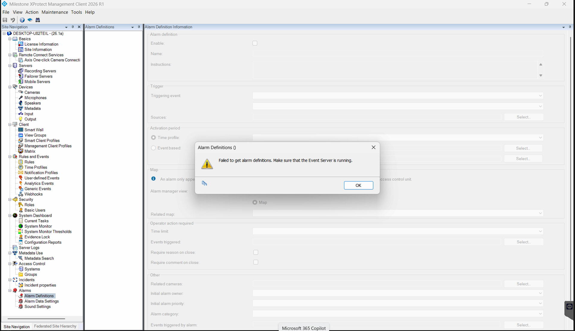

I have installed the Access control plugin. First time I was able to add in Mielstone system and able to see in xprotect smart client. After adding alarm and restarting event server, the access control plugin is not detected by the Milestone system.
Event server is already running. I cannot attach more media. It was saying “I am new user and cannot have more than one media attached.“
I think I found the root cause. It happened after I created alarm and restarted the event server. For the alarm configuration, I used my plugin category as trigger (Access granted) and bind to the all door. It didn’t happen in Milestone 2025 R3 version.
Can you advice me what is the workaround for now.

Based on your description, the fact that Alarm Definitions are no longer visible suggests that the Event Server enters a bad state that affects more than just the Access Control plugin itself.
At the moment, the only workaround I can suggest is not creating the Alarm Definition, as that appears to trigger the issue after the Event Server is restarted.
You could also try removing the Access Control plugin and restarting the Event Server. If the plugin is contributing to the condition, this may allow the Event Server to return to normal operation. Of course, this would also mean that the Access Control integration would not be available, but it may help determine whether the rest of the VMS functionality is unaffected.

I uninstalled the plugin but the behavior was still the same. The only workaround was to reinstall the Milestone from scratch.
