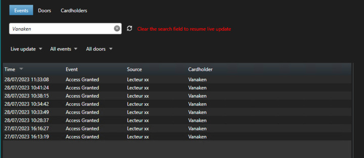

When I open the Smart Client, the event screen displays some events which are always the same (NOT the result of the last session). Notice that no card holder appears in the search box.
Then, I go in the Cardholders tab and select one person.
And I click on “View cardholder events”.
This displays events for that person (notice that the name is now displayed in the search field).
Then I click on the ‘x’ to clear the search field. And I get the following result, totally different from the one I got when I opened the Smart client. Note that there are events not related to any cardholder.
This is the complete event history (although in the screenshot here, there’s only one person displayed).
What I don’t understand is the initial display. Intuitively, I would think that it should be either empty or the complete history, like the one I get after clearing the search.
I hope this helps you to understand the issue.
