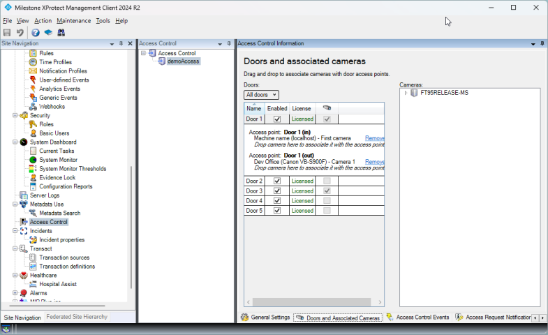

Cameras can then be associated to those APs from the Management Client.

it’s the first time I use the ACM Framework, my fear was that, in addition to the association with the cameras, the Access Points were used in some way by the Framework.
I had already created ‘fake’ Access Points and associated the cameras to the gate.
