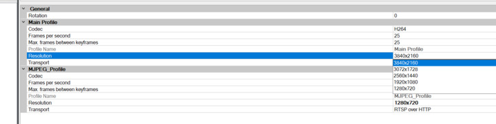

How can we make adaptive streaming work with the driver framework? We have a Resolution enum setup field but the Smart Client does not switch to the lower profile when adaptive streaming is enabled. Our driver support 8x 4K channels so adaptive streaming is very important here.

This is not entirely relevant but I have a comment to your question. It seems to me your screen capture shows two profile not two streams, two streams is the requirement for getting adaptive streaming to work. Maybe you do have streams based on the profiles, but unfortunately then we are back to the lack of support for adaptive streaming.

And yes, we do have multiple streams enabled:
