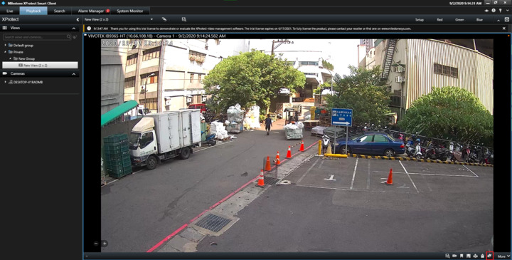

SCToolbarPlugin shows how to add a customized toolbar, and it indeed works in both Live and Playback. For example, see following screen shot.
While in Search, the toolbar doesn’t show.

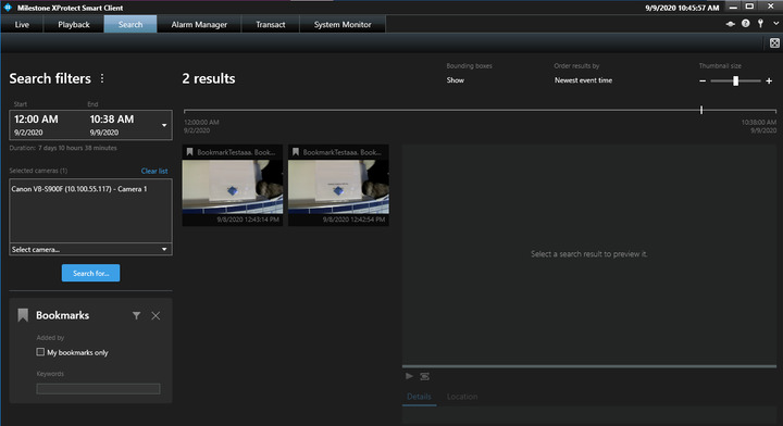

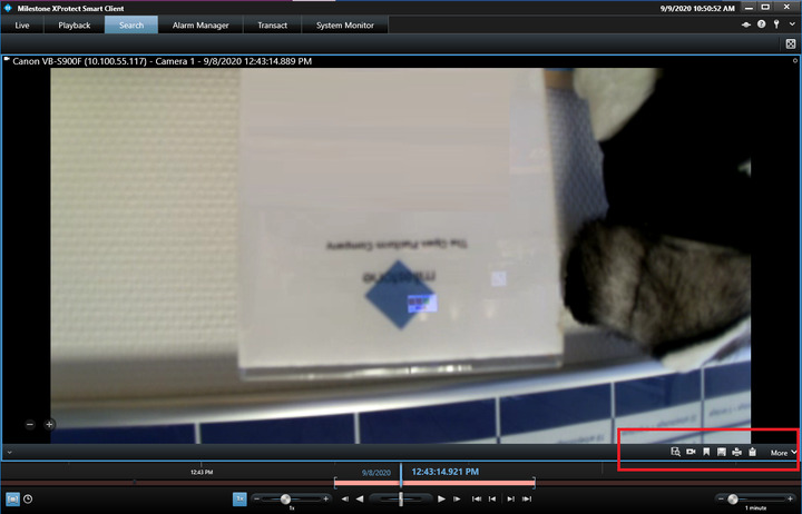

What you want to do is - first, search -
And double click one of the results, and you can see the video with a big view (please see below picture and the red square, is this what you want to do?)
Thanks, and yes we want to add a customized plugin in the red square area.
