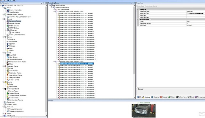

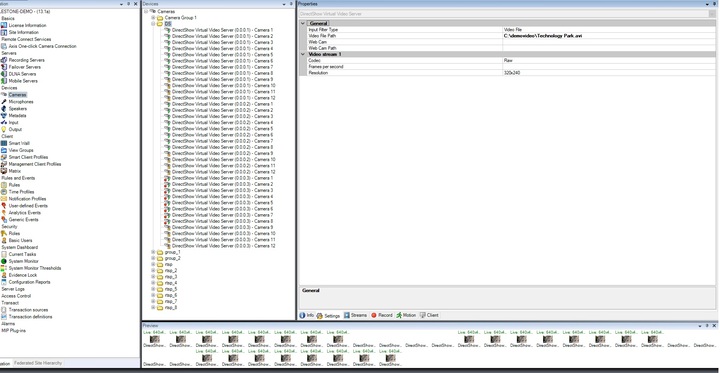

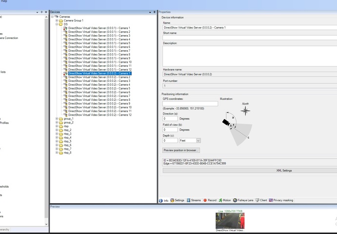

About DS I’ve got the next
I stand corrected! :slight_smile:
Thank you for the good news.
Thanks for the support. :slight_smile:
You’re welcome.
But you’re right about 8 channels per one DS hardware. Even for 12 channels per DS only 8 are working, but I’ve not dived deeper yet with it. I hope it could be fixed like adding another +1 DS hardware.
As result, for now, it’s possible to add more than one DS HW but only with 8 channels.
