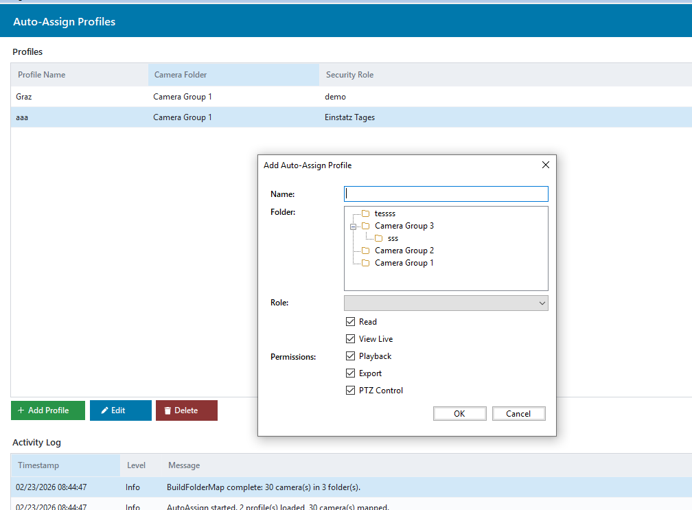

@Bo_Ellegard_Andersen I found a solution for customer via an admin plugin.
I subscribe to detail config changes and can detect the new hardware and folder assignment. The plugin allow to add “Auto assignment profiles” where a role and folder, needs to configured.
Whit this approach the new hardware gets automatically a set of permissions in the role.
I want just to note this here for reference, if someone has a similar thingy.

@Zelliey Thanks for your suggestion. The issue in my case is that I need to react to the change immediately, so PS Tools was not really an option.
The solution now runs as a plugin within the event server, where it detects permission changes and updates them instantly. I did look into using PS Tools, but it seems more like a manual utility or something that can be triggered by a scheduled task.
