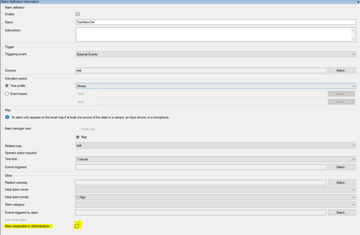

Hello,
while creating an alarm definition using the Configuration API there is no way to set the “Alarm assignable to Administrator”-Property.
I also checked in the Config API Client sample and this property is missing aswell on the list of alarm defintion properties.
Is there any other way to set this property via Config Api?

I can confirm this is missing when I test the same. I will ask Milestone Development to investigate.
