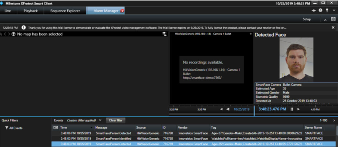

We previously had a working alarm preview integration a few years back. Our setup worked as follows:
  • Analytics events were sent to Milestone.
  • A custom alarm preview plugin rendered additional information from these events inside our UI component (See attached image).
Current Behavior:
  • Analytics events are still being sent to Milestone correctly.
  • The alarm preview plugin seems to be loaded (confirmed in the About section of Smart Client).
  • However, after clicking on our event, nothing is rendered by our alarm preview plugin.
