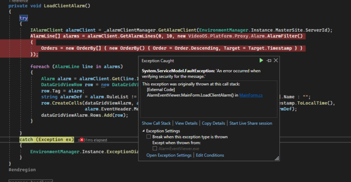

AlarmEventViewer sample not working with latest MIP SDK 2023R3 with latest X protect
System.ServiceModel.FaultException: ‘An error occurred when verifying security for the message.’
I am getting this error while running latest AlarmEventViewer sample pls help urgent
