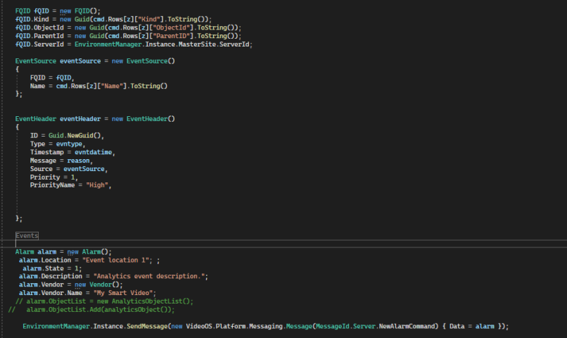

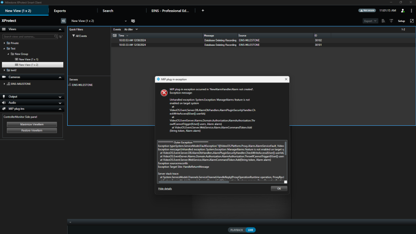

We are currently trying to add alarms using the Alarm Preview plugin, but we are encountering an error when triggering any events or alarms. Please find the error message in the attached screenshot for your reference.
Additionally, we have included a sample of the code we are using below, in case it helps you understand the issue better.

I want to integrate my access control alarms in the same system, so I tried using the code shown in the screenshot. However, as you can see, I opened the wrong window (labeled “Events”), which is not the intended window for uploading alarms. When I attempt to upload the alarm events, the same error occurs.
Suggest me the correct way to integrate the same.
