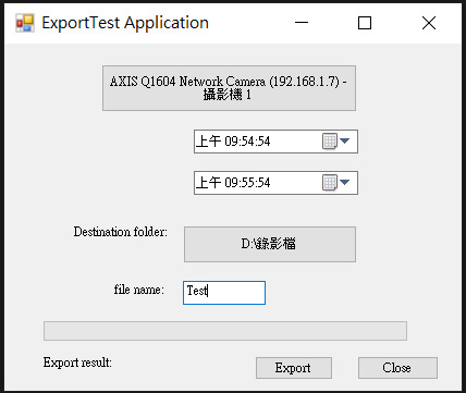

window form:

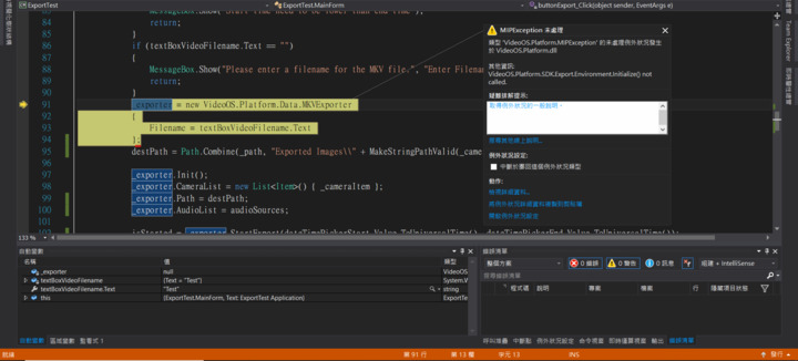

Press the export button.The following error message appears.
I execute exportsample with success. But I develope this window form can not be execute. what is the problem?
Thanks!
My guess is that you did not do VideoOS.Platform.SDK.Export.Initialize()
Please see if the Export Sample works, if it works compare the code, try to focus on the initializations as they are probably where the problem happens.

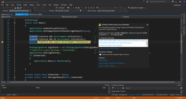

Thank you for your answer.I really forget to do VideoOS.Platform.SDK.Export.Initialize()
But after I add this code, new error message appears.
What’s the problem?
My guess is that you have not done the copy of the dependent files.
Please read the second link that I sent yesterday. This might be helpful for you. Hint: CopyExportFiles.bat
