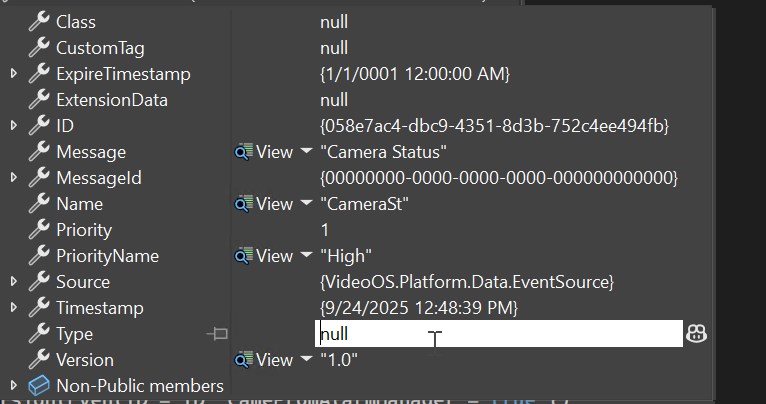

Analytics events missing CustomTag and Type fields in EventHeader in 2025R2

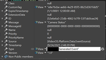

In 2025R2 a analytics event sent from Event Server with CustomTag and Type fields filled in, arrives in Alarm Manager with them null (viewed in AlarmPreviewWpfUserControl with Alarm alarm = alarmOrBaseEvent as Alarm;) @Eric Bourque
Same code works fine in 2024R2
