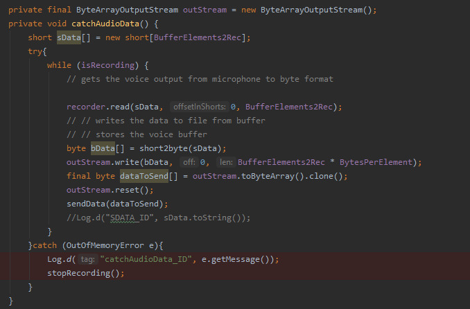

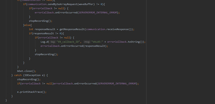

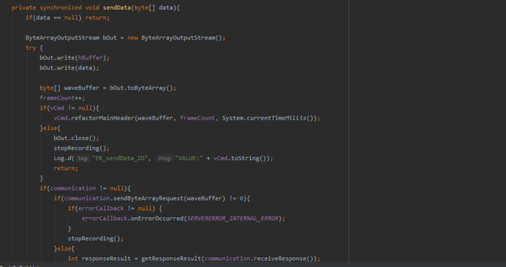

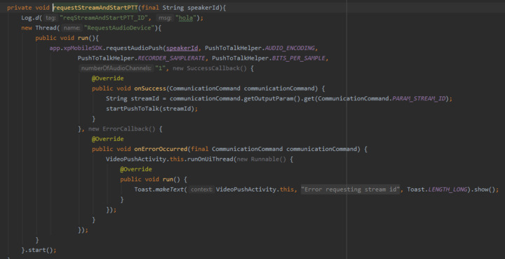

I see that the problem comes from the video push sample where when freeing memory, it interrupts the live video stream. Some parts of the code:
I would like to know if you can help me so that the video stream is not interrupted.

The code samples you’ve listed are related to Push-to-talk (audio push) part of the video push - is the error still there if you don’t do audio push?
If you look at the memory usage (in the android studio profiler), is it steadily rising in those 40 minutes the app is running?
If so, probably there is a memory leak somewhere, or the garbage collector is not able to catch up with freeing the memory. You could try to use static buffers in short2byte and catchAudioData functions, which are reused every time, instead of dynamically allocating new ones on each call, and see if this helps
