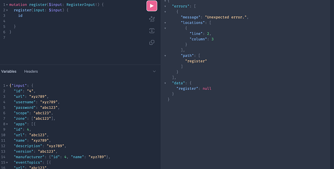

I do a register mutation via graphIQL

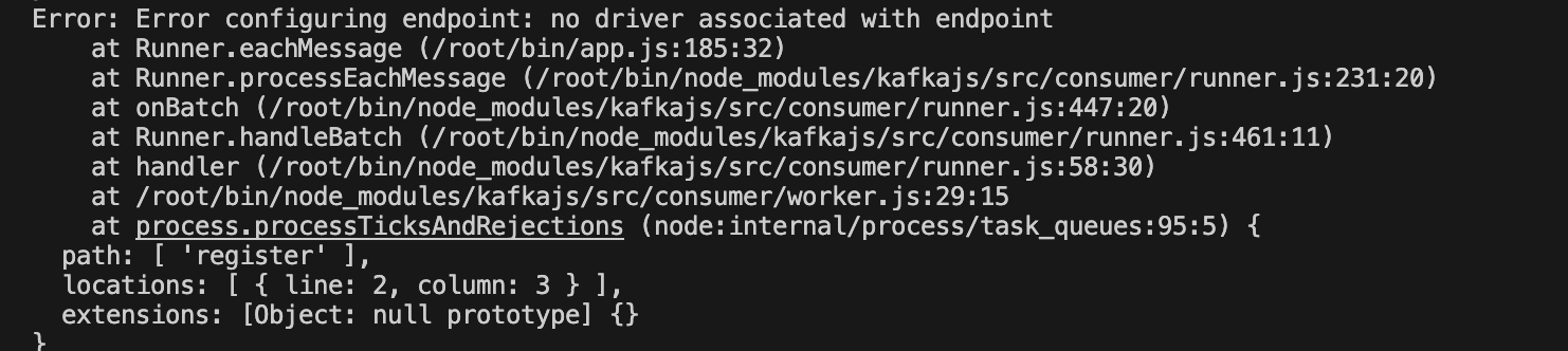

and I looked in the logs of the container `nvcr.io/isv-milestone/partners/aibridge-webservice:v1.7.2` where I see

I get the same error
  "errors": [
      "message": "Unexpected error.",
      "locations": [
          "line": 2,
          "column": 3
      "path": [
        "register"
  "data": {
    "register": null

Hi I changed my input so all ids are GUIDs
{"input": {
  "id": "5901ddcb-76bd-4d15-b0b5-9048c8fcd102",
  "url": "xyz789",
  "username": "xyz789",
  "password": "abc123",
  "scope": "abc123",
  "zone": ["abc123"],
  "apps": [{
  "id": "67842f3c-0940-4ea2-8a8c-1379e97dfb9f",
  "url": "abc123",
  "name": "xyz789",
  "description": "xyz789",
  "version": "abc123",
  "manufacturer": {"id": "d790d8a9-4e60-416a-b855-0c40d91039bb", "name": "xyz789"},
  "eventTopics": [{
  "url": "abc123",
  "name": "abc123",
  "description": "abc123",
  "eventFormat": "ANALYTICS_EVENT"
  "metadataTopics": [{
  "url": "abc123",
  "name": "xyz789",
  "metadataFormat": "ONVIF_ANALYTICS"
  "audioTopics": [{
  "url": "abc123",
  "name": "xyz789",
  "audioCodec": "G711"
  "videoTopics": [{
  "url": "abc123",
  "name": "xyz789",
  "videoCodec": "MJPEG"
  "configMaps": [{
  "name": "abc123",
  "clear": false,
  "default": true,
  "properties": [{
  "key": "xyz789",
  "value": "abc123"
  "licensors": [{
  "id": "1769ebb6-82f6-439f-ad68-146c7456beea",
  "name": "abc123",
  "licenses": [{
  "id": "0f2954d1-67ff-448f-aaae-81fa112c4a8a')",
  "name": "xyz789"
but when I do the following mutation in graphiql
mutation register($input: RegisterInput!) {
  register(input: $input) {
    id
I still get
  "errors": [
      "locations": [
          "line": 2,
          "column": 3
      "path": [
        "register"
  "data": {
    "register": null

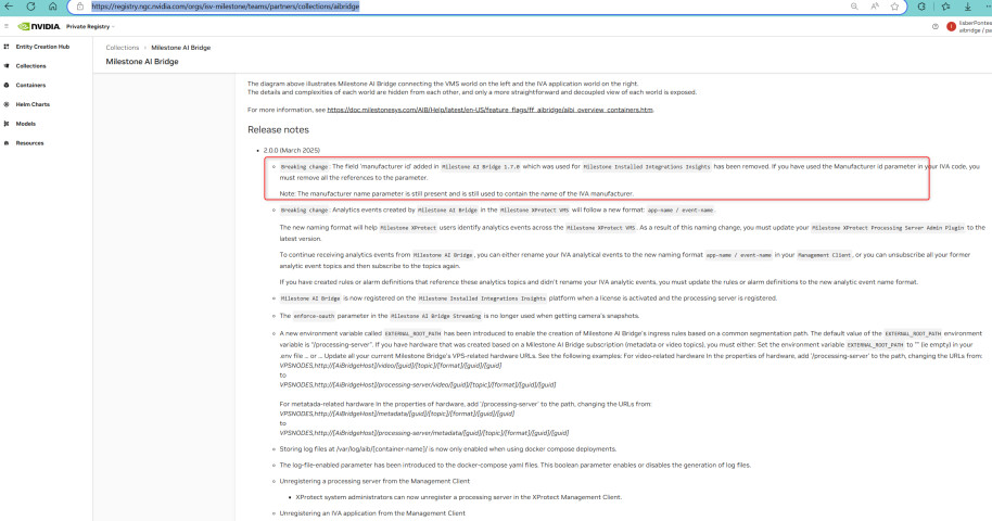

Hi there,
This time the problem was that I was working with AI Bridge 2.0.0 (which I strongly suggest you to use).
If you check the release notes, we’ve deprecated/removed the field ‘Manufacturer → id’ on 2.0.0.
So if you’re using 1.7.2 then you should pass this field. But again, we encourage always to use the latest version and to check the release notes (you can find them in the NGC catalog:
Milestone AI Bridge | NVIDIA NGC )
