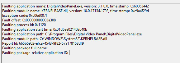

When I check the Windows event logs, I see the following error:
I am suspecting that maybe I forgot to install something that Milstone requires but I am uncertain what. Again, this does not occur on all machines and only some of them.

In Milestone Technical Support we have experienced crashes in Smart Client and in integrations using the ImageViewerControl, issues that have been solved by upgrading the graphics driver for the PC. Please try to upgrade your graphics driver.
