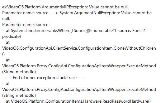

This did not fix it, and is essentially what I had before. It fails at:
ServerTask servertask = hardware.ReadPasswordHardware();
Giving the following error:
I can loop through and see the properties (username, Address, etc.) for each device but as soon I call ReadPasswordHardware() it throws the error in the attached image. I am trying to do this from Activate() in a Toolbar Plugin, i.e. when the toolbar item is clicked. Here is the full code:
try
                var ms = new ManagementServer(EnvironmentManager.Instance.MasterSite);
                var hardwares = ms.RecordingServerFolder.RecordingServers.SelectMany(rs => rs.HardwareFolder.Hardwares);
                foreach (var h in hardwares)
                    // This works
                    string keyStr = "";
                    foreach (var key in h.GetPropertyKeys())
                        string prop = h.GetProperty(key);
                        keyStr += key + " " + prop + Environment.NewLine;
                    MessageBox.Show("key list...\n" + keyStr);
                    // Fails here
                    ServerTask addHardwareServerTask = h.ReadPasswordHardware();
                    while (addHardwareServerTask.State != StateEnum.Error && addHardwareServerTask.State != StateEnum.Success)
                        System.Threading.Thread.Sleep(1000);
                        addHardwareServerTask.UpdateState();
                    MessageBox.Show("Hardware add task: " + addHardwareServerTask.State);
                    if (addHardwareServerTask.State == StateEnum.Error)
                        MessageBox.Show("Hardware add error: " + addHardwareServerTask.ErrorText);
                    else if (addHardwareServerTask.State == StateEnum.Success)
                        //string path = addHardwareServerTask.Path;       // For the added hardware
                        foreach (var p in addHardwareServerTask.GetPropertyKeys())
                            MessageBox.Show(p + "=" + addHardwareServerTask.GetProperty(p));
                        // alter other camera properties(?)
            catch(Exception ex)
                MessageBox.Show("ex: " + ex);
