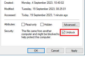

When downloading a MIP plugin from the internet, the downloaded files are “blocked”, and the plugin fails to load with a NotSupportedException in the mip logs and the following error message:
An attempt was made to load an assembly from a network location which would have caused the assembly to be sandboxed in previous versions of the .NET Framework. This release of the .NET Framework does not enable CAS policy by default, so this load may be dangerous. If this load is not intended to sandbox the assembly, please enable the loadFromRemoteSources switch. See http://go.microsoft.com/fwlink/?LinkId=155569 for more information.
To fix this you can unblock .dll in the file properties:
It works, but is a bit cumbersome. Is this supposed to be the standard procedure or is there a way around this?
This is standard Windows functionality and will also happen for other non-plugin dlls. I suggest requesting the plugin developer to provide you with an installer for the plugin instead of the raw files.
