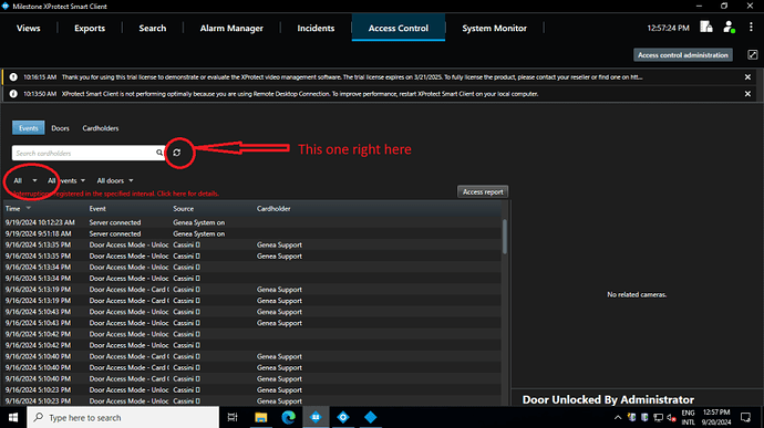

Call an API on Refresh Button under Access Control Tab in XProtect Smart Client
Is there any way we can customize the plugin code to execute some additional code on the click of the refresh button which can be found under the Access Control tab of XProtect Smart Client when you select All.
Hi Vishal, sorry for the late response. Currently it is not possible to subscribe to the button press.
What would you like the plugin to do when the button is pressed? Maybe there is a different way to achieve the same result.
