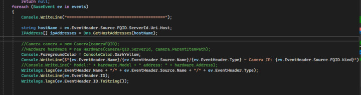

using VideoOS.Platform;
using VideoOS.Platform.ConfigurationItems;
FQID fqid = ev.EventHeader.Source.FQID;
if (fqid.Kind == Kind.Camera)
	Camera camera = new Camera(fqid);
	Hardware hardware = new Hardware(fqid.ServerId, camera.ParentItemPath);
	Debug.WriteLine(camera.DisplayName + " address: " + hardware.Address);
There is a chance that you will receive answers from other users of the Forum, if my answer doesn’t make sense and you don’t want to ask questions based on the code I post.

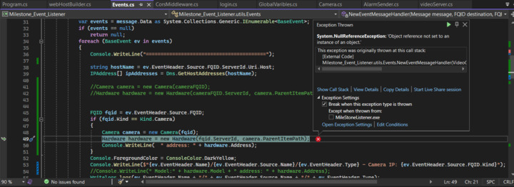

this is the same exact code that i’ve tried but not work with my case
Then please debug and explain how it fails.

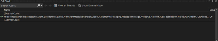

this is what happen :
Are any of the two parameters null?
Show me what they contain and include the call stack..
what is the call stack ?
21
Look at the previous picture you sent, there is a ‘show call stack’.
I need you to debug and show values not code.
ok
