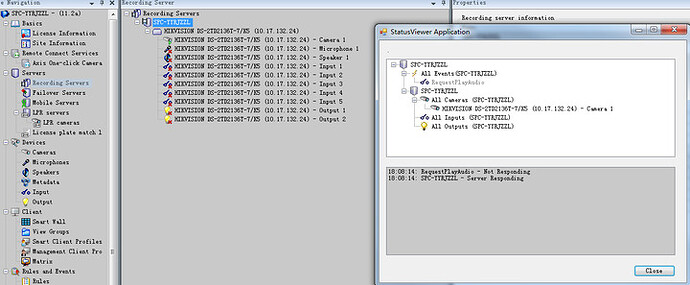

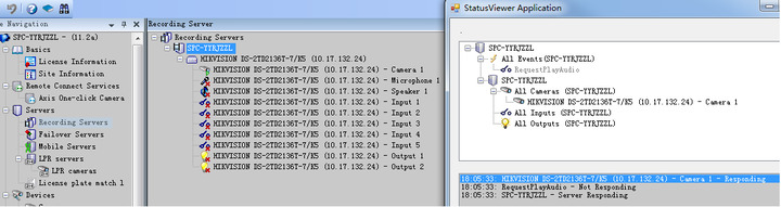

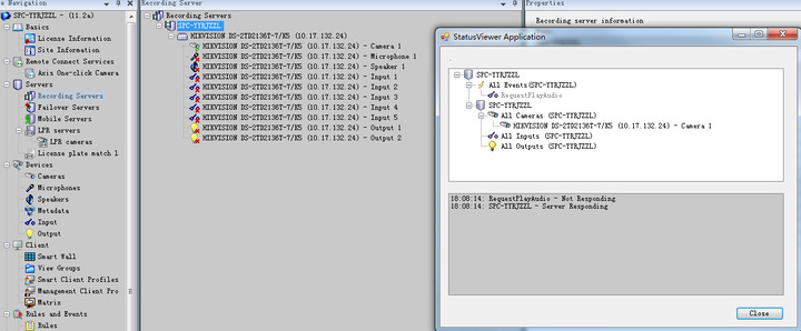

I use StatusViewer to get camera status from the event server:
1.I get the right status by first one
2.delete the camera
3.add the same camera​ again
4.can not get the status like step 1
5.if restart the event server, the status resume
is that a problem with event server?​
