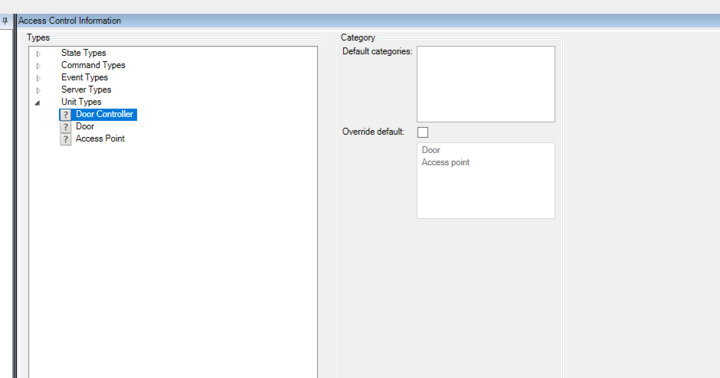

I want to create a category for setting it to an element AcUnit.
The problem is that when I create the category, I don’t find it in the category list of the tab “Category mapping”.
The rest of categories save correctly.

This is the tab “Category mapping”:
Can someone help me, please?
Milestone Development will start an investigation.
It seems there is a bug with creating this type of Category. We have logged it and will fix it in the future. What did you intend to use the categories for? Maybe there is a different way to achieve the same thing.
