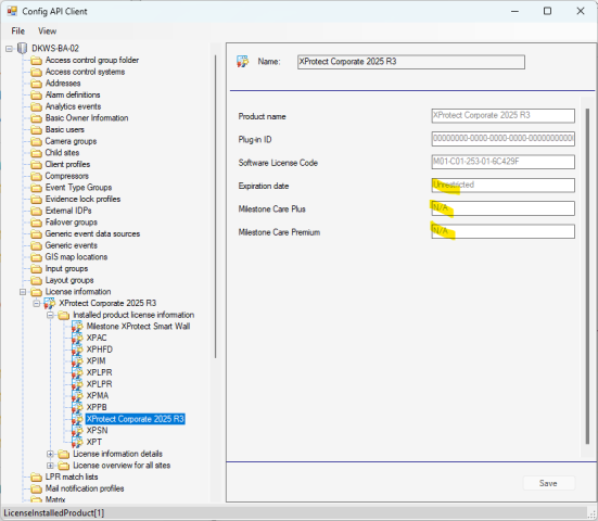

My test system doesn’t have Care (in fact it cannot have Care as I have a release candidate of the upcoming 2025R3). Assuming your test installation does have Care what do you find if you navigate to this? –
Bo,
Ah! You are correct.
I was not navigating down to the correct location.
I ran the Config API Client on our Milestone Server and then it indeed DOES show the correct Expiration dates for Care Plus and Care Premium.
Now, I just need to figure out how it gets it.
