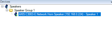

I have connected Axis speaker to Milestone management client. and management client show correct status.
But in Status viewer MIP SDK sample I get the initial status of the speaker but on change event is not received

I just tested the sample with above code and it works fine. What I did was: I triggered events from the speaker/microphone and I could see the events on the sample so it should work.
Can you please verify if your device works properly? I mean, please check and see if the icons on the device in Management Client are green?
