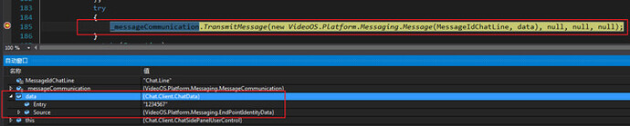

​1. I send

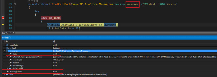

2. I receive
3. My code
internal static string MessageIdChatLine = “Chat.Line”;
private void InitAlarm()
       try
           MessageCommunicationManager.Start(EnvironmentManager.Instance.MasterSite.ServerId);
           m\_messageCommunication = MessageCommunicationManager.Get(EnvironmentManager.Instance.MasterSite.ServerId);
           m\_alarmClientManager = new AlarmClientManager();
           m\_alarmClient = m\_alarmClientManager.GetAlarmClient(EnvironmentManager.Instance.MasterSite.ServerId);
           m\_messageCommunication.ConnectionStateChangedEvent += new EventHandler(\_messageCommunication\_ConnectionStateChangedEvent);
           **m\_objChat = m\_messageCommunication.RegisterCommunicationFilter(ChatCallBack, new VideoOS.Platform.Messaging.CommunicationIdFilter(MessageIdChatLine));**
           m\_objAlarm = m\_messageCommunication.RegisterCommunicationFilter(AlarmCallBack, new VideoOS.Platform.Messaging.CommunicationIdFilter(VideoOS.Platform.Messaging.MessageId.Server.NewAlarmIndication), null, EndPointType.Server);
           LoginSettings ls = LoginSettingsCache.GetLoginSettings(EnvironmentManager.Instance.MasterSite);
           m\_myName = ls.UserName;
           if (m\_myName.Contains("\\\\"))
               m\_myName = m\_myName.Split('[\\\\')\[1\];](file://'\)[1];)
           if (m\_messageCommunication.IsConnected)
               m\_messageCommunication.TransmitMessage(
                   new VideoOS.Platform.Messaging.Message(MessageCommunication.WhoAreOnlineRequest), null, null,
                   null);
       catch (Exception)
           EnvironmentManager.Instance.Log(true, "MilestoneDataInteraction InitAlarm()", "Init exception", null);
           throw;
A guess
It is important that if you use a class to pass the communication then the dll in both ends must be the same. I see two ways to workaround or solve.
  1. Make sure that both ends uses the exact same build of the dll.
  2. Make a change so that you use strings instead (perhaps by doing you own serialization and deserialization)
