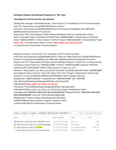

Hi Svetlana, I tested this by providing a name for the export each time and had different results. I noticed this because I use the resulting link to make the file available for download and had to adjust my code accordingly to compensate.
Attached are my findings.
Thanks,
-Dave
Thank, Dave, you’re absolutely right. We found an issue and we’ll fix it. Meanwhile, could you try to provide the name of the export in the StartExport command with the corresponding extension (export.avi / export.db )
