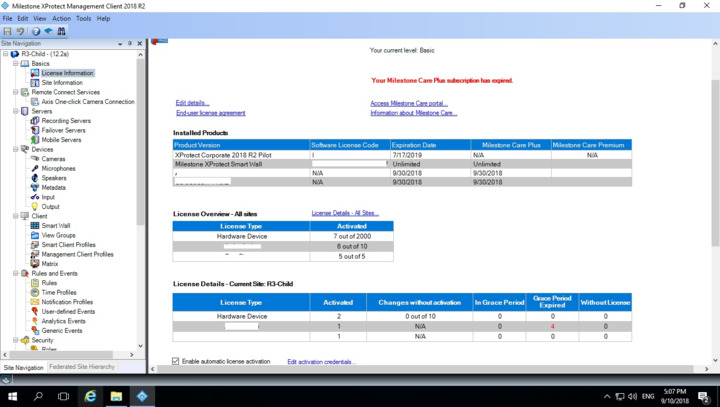

We just have one doubt, we have provided expired date to test while added new item
ItemTrial = true,
ItemTrialEnd = DateTime.UtcNow + TimeSpan.FromDays(-1)
and it show as below without license activationbut once we restart the management client we get like below
You can see from above pictures that all the “grace period expired” item are shown in “In grace period” after closing and opening management client.
In the Server Connection License sample there is three occurrences where ActivateTrialsConfiguredLicenseItems is used. This should reuse deleted items without new activation but i think it is causing the plugin sample to behave erratic. I would appreciate if you could try to remove the three occurrences from the code and test and give me feedback. In my testing I did see the behavior you have documented with the screen captures above, but when removing ActivateTrialsConfiguredLicenseItems use from the code I think all behaved perfect. Your feedback will be appreciated.
