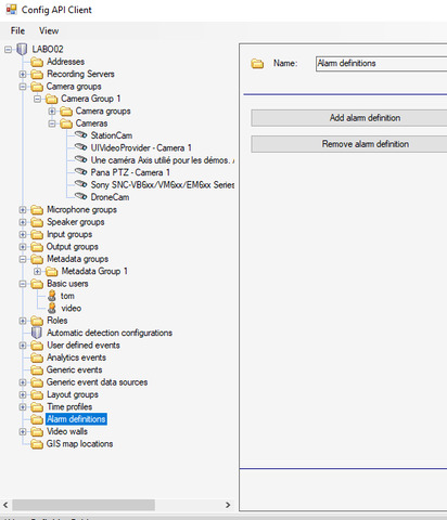

The alarm definitions are not loading in the example. I saw them appear once yesterday but today they are not there. All I did since was activate/deactivate some plugins but now I can’t get the list back anymore. How can I debug this?
Listing the alarm definitions require the Event Server to be running so make sure that is the case. Also please check whether they are listed in Management Client.
Finally, try debug config API client to see if it receives any exceptions (and silently catches them) while fetching.

This is a bit of a mystery. Is the Alarm definitions top node there in the config API client?
Btw you are also aware that we did a change so that sub nodes are not populated in Config API until you select the top node for that category, right?
Finally, assuming you are running 2018 R2?

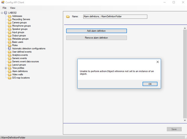

I am not sure which log it would be since I am not entirely sure of what is happening, but one of the logs in [c:\ProgramData\Milestone\XProtect](file:c:/ProgramData/Milestone/XProtect) Management Server\Logs\
Regarding the exception I meant the one you got when pressing the Add alarm definition button in config API client. You showed a screenshot of that a few posts ago. That looks very much like a null reference exception.
Oh yeah that one.
Yes it is a null ref

InvokeMethod:Object reference not set to an instance of an object.
Exception thrown: ‘System.ServiceModel.FaultException`1’ in ConfigAPIClient.exe
Exception thrown: ‘System.Net.Sockets.SocketException’ in System.dll
Exception thrown: ‘System.IO.IOException’ in System.dll
Exception thrown: ‘System.Net.WebException’ in System.dll
Exception thrown: ‘System.Net.WebException’ in System.Web.Services.dll
ConnectionCheck for:https://labo02/, Took:15450ms
It is the FaultException that is quite interesting. Can you try finding the try/catch that shows the messagebox, set a breakpoint there and then see the details of the exception. It would be really nice to see the server side exception leading to the fault exception.

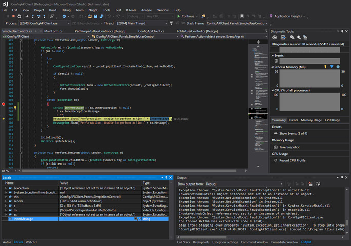

I would rather expect it to be in SimpleUserControl.PerformAction method due to the MessageBox and the “Unable to perform action” text. If you put a breakpoint in the exception handler (SimpleUserControl.cs line 203) you will hopefully be able to see an inner exception (if I am correct) - it would be really helpful to get the details (e.g. call stack) of that.
Ok il take a look tomorrow
Sorry, took me a while to get back to this. Here is the exception on line 203:

Eric, Please try to set a BreakPoint at line 203, and see what the InnerException explains. Could be Communication from Management Server to Event Server is not working?
Hi Anders,
I can’t see any inner exceptions.
All the other configuration items are coming through just fine…
no, but now you have a NullReference Exception - what is the stack trace showing?
“System.ServiceModel.FaultException`1[VideoOS.ConfigurationAPI.ConfigurationFaultException.ServerExceptionFault]: Object reference not set to an instance of an object. (Fault Detail is equal to VideoOS.ConfigurationAPI.ConfigurationFaultException.ServerExceptionFault).”
