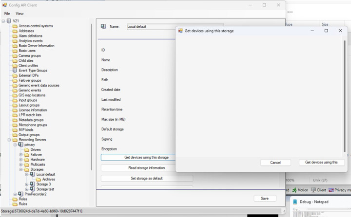

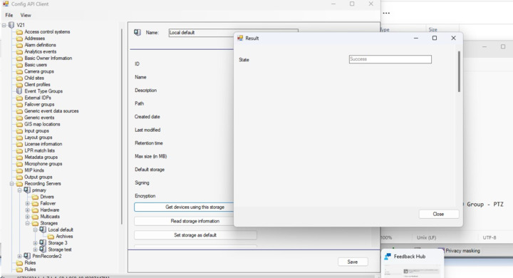

Config API sample GetDevicesUsingStorage does not return the devices using the storage; we get an empty list, but the call succeeds.
Using the latest SDK 2023 R3
When we debug, we see the underlying wrapper has configitem(devices using storage)
ClassCollectionServerTask task = PrimStorage.GetDevicesUsingStorage();
task.SupportedChildItemType → shows all supported devices
task.ChildItemClassCollection → this is empty

The result is in the ClassCollection property, not the ChildItemClassCollection.
There is a bug in Config API Client sample causing it not to show the result correctly. We will fix this for the next release.
