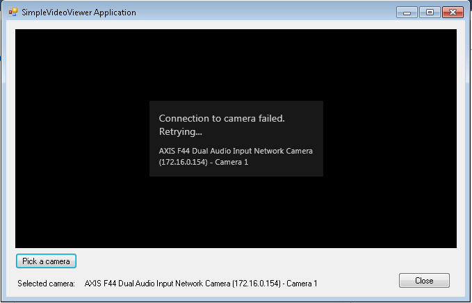

I’m new to MIP.
I’m getting this message on the ImageViewerControl - the Initialize and Connect went fine without errors.
I’m getting this even on the SimpleVideoViewer from the milestone course.

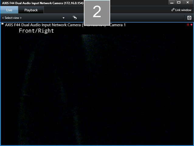

I can see the camera just fine on the client. I get the error only on the SDK ImageViewerControl.

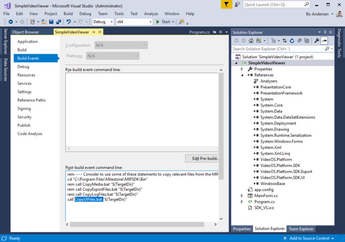

I ran the SimpleVideoViewer. My experience is that I can make it work but there is one small thing:
The SimpleVideoViewer has a Post-build event command line and this uses CopyImageViewerActiveX.bat, this batch file has been renamed, please use CopyUIFiles.bat instead.
From what I found I must suspect that the error you see stems from have a wrong set of dlls. I hope you find that using the right files solves the issue.

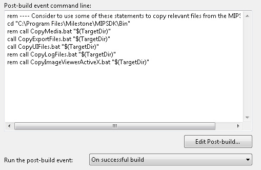

I did exacly that! When I noticed the CopyImageViewerActiveX.bat is missing in 2018 R2 I used the UI one (it’ll be nice if the course can updated, as it took me some time to figure it out).
Let me just show you what I see.
This is the compile (The SimpleVideoViewer):
This is from the server (its night in our place):
This is from the C# (The SimpleVideoViewer):
Anything I did wrong there?
