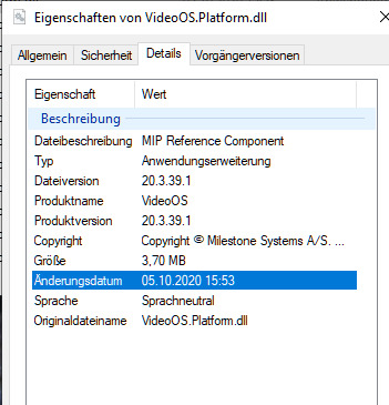

We have tested NewLicense method in ServerConnectionDump.cs in ServerConnectionLicense sample and it is working fine, so we have not reproduced this issue. We are using 2020 R3 both VMS and SDK.

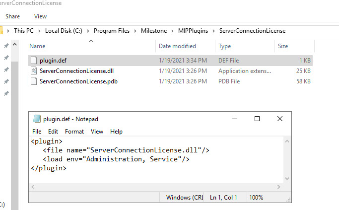

Note: If you want to run ServerConnectionLicense, please remove or comment out
from plugin.def because we want to see if Event server plugin works. (plugin.def file is located [C:\Program](file:C:/Program) Files\Milestone\MIPPlugins\ServerConnectionLicense)

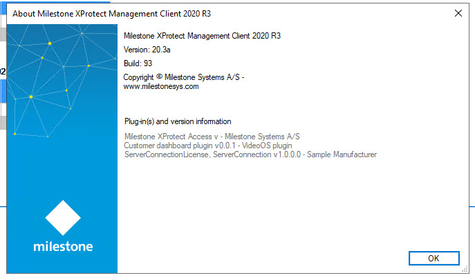

PlugIn should run on the server (see picture below).
