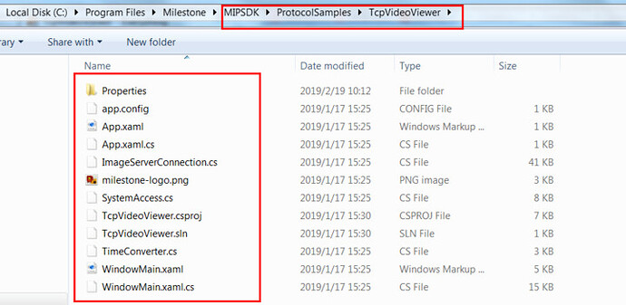

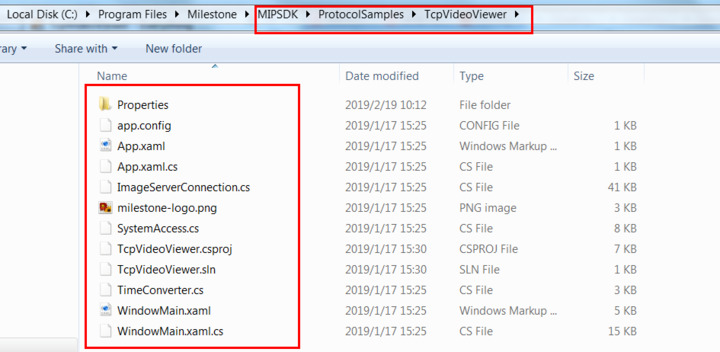

Could you please tell me how to get TcpVideoViewer sample ?
I have found the answer, could you please how to run this TcpVideoViewer Example?​
You will have to use a Windows PC with Visual Studio and build the project to see it run.
