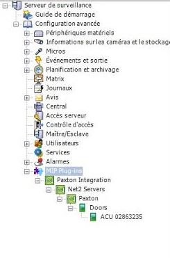

My goal is to have something looking like that for my plugin
Can you tell me which classes I’m suppose to use to have a similar looking result?

When placing your plugin in the appropriate Program Files folder \Milestone\MIPPlugins, you should see the plugin tree structure under the “MIP Plug-ins”. If not so, something must be missing or misplaced. Remember to build and place the 32-bits plugin in the 32-bits MIP plugin folder.
Also, I recommend looking at the Access Control sample, which demonstrates exactly what you are requesting.
