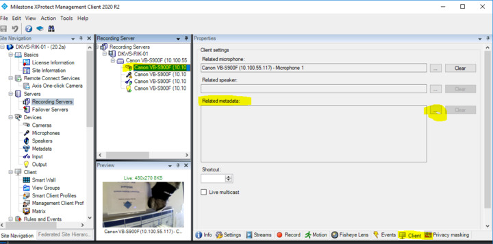

The goal is to not have as little config on client as possible. Any ideas of how I can match together video streams and metadata streams?
I have previously made a plugin for drawing overlay on video, I need to change the source to metadata and understand how to get the correct one, as well as understand when to do it. Is metadata event-driven? Can I listen for change in metadata input on the client?
The easiest way to match together video stream and metadata stream is to assign them on Management Client, please see below picture for setting them -
