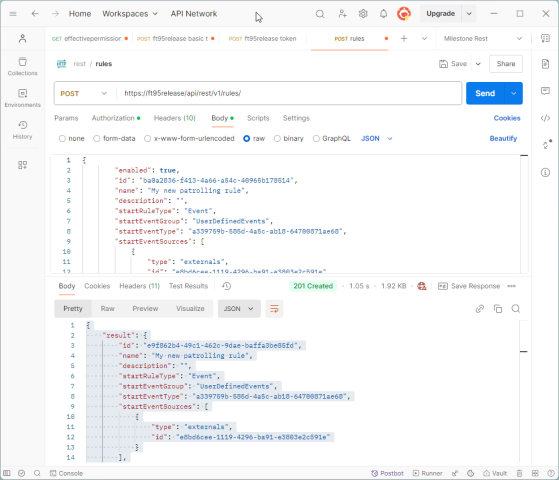

In order to show you how it can be done I cheated a little. I create a new rule in the Management Client. I read it using the RESTful API doing a GET. I copy the output. I do a POST instead, I use the copied JSON as body in the POST request but change the name and the id. Doing this the POST will make a new rule for me.
Hello, using this solution that you commented has worked for us, thank you.
