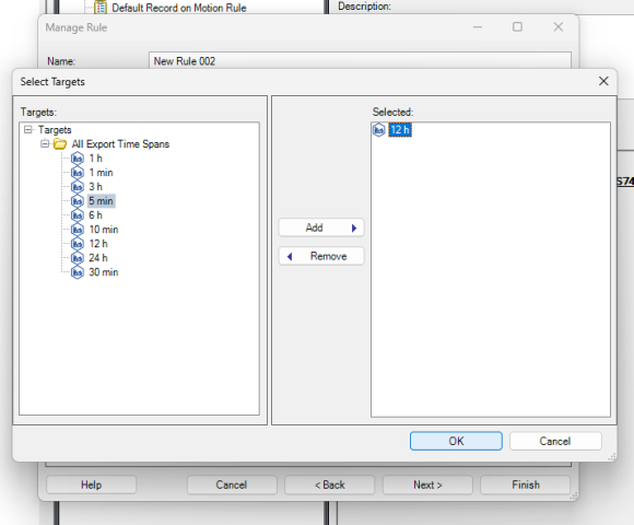

According to the BatAction example we implemented a RuleAction.ActionManager which returns an ActionDefinition with two ActionElements, onbe of which is of Kind.Camera and a custom Kind. The custom kind we registered in the PluginDefitnition as a ItemNode of the same custom Kind which is used for the ActionElement.
This works as far as we can select the camera and the custom kind, which represents a time span in this case. The selections are persisted and the rule is executed according to the trigger definition.
But, when the actual call to RuleAction.ActionManager.ExecuteAction2 is made, the parameter for the second action item actionItems2 is empty.

The code reporting the “Failed to lookup action target” is trying to look up the FQID of the item you have selected, so my guess is that something is going wrong in the ItemManager delivered by your plug-in. Maybe you can put some logging in the GetItem methods and see whether they are called when the rule executes and if so whether they succeed in looking up the Item?
When the rule executes, the ItemManager’s GetItem methods are not called at all.
The GetItems() is called when configuring the rule. The GetItem(…) methods with parameters are never called.
Here is the GetItems() implementation:
