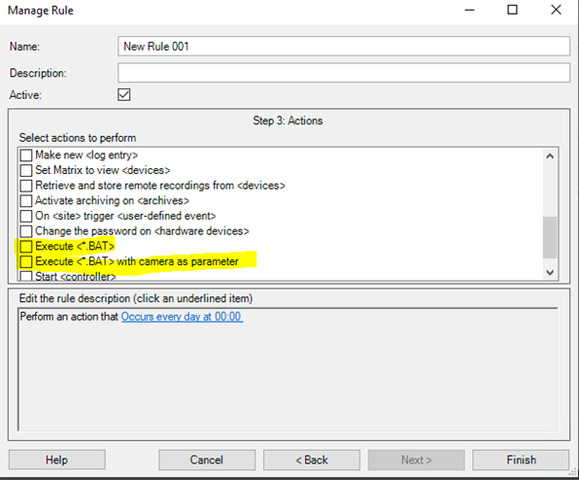

1, This is not supported.
2, It is possible to configure Recurring time as start action and select Execute BAT as action to perform on Management Client. Please see below picture.
3, We don’t support all those kinds but at least, it is possible to use devices (Kind.Camera, Kind.Microphone, Kind.Output etc).
NOTE - Are you using the newest MIP SDK? If not, please use the newest, because this functionality was added to recent versions so if you use old SDK, you might not be able to use.

  1. is not working for me in 2020R2 Corporate, see https://imgur.com/a/8nMQuk4
I’m using MIPSDK 2020R3 or 2021R1, I have to check.
Hello,
Regarding the previous reply from us, I had tested XPCO 2021 R1 and SDK 2021 R1 and it’s working fine.
I just now tested XPCO 2020 R2 which is same version as yours and SDK 2021 R1 and XPCO 2020 R3 and SDK 2021 R1. But both don’t work, same results as your picture.
So 2) is not supported if you don’t use XPCO 2021 R1 or older.
