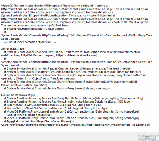

I have a code on Csharp which is a plugin that should be entered on XProtect Management Client 2022 R2, but it only works on my XProtect Management Client 2018 R3
Gets an error message that it does not reach the end-point milestone-labb.demo.local:22331,
Have checked the latest documentation to see if something needs to be changed but can’t find anything
The Concurrent License option was discontinued. This was announced as a breaking change, ref.:
https://doc.developer.milestonesys.com/html/index.html?base=gettingstarted/mip2020r2_intro.html&tree=tree_search.html?search=concurrent
Okay thanks then I’m in, what would be the solution to my problem anyway?
You will have to remove the code in the plugin which uses Concurrent License, and then rebuild.
I wonder if you can change your code so that you use one of the other license check schemes instead. Ref. License Check Schemes - https://doc.developer.milestonesys.com/html/index.html?base=reference/architecture/miplicenseintroduction.html&tree=tree_1.html
