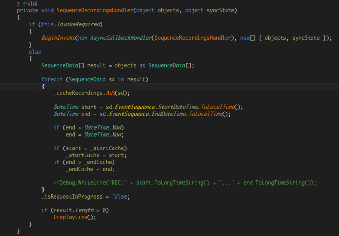

for example:
I can get the SequenceData[] for all cameras, and then pick out the target SequenceData from all the SequenceData[]
A PlaybackController and a PlaybackController+PlaybackUserControl combination can be shared for many cameras.
