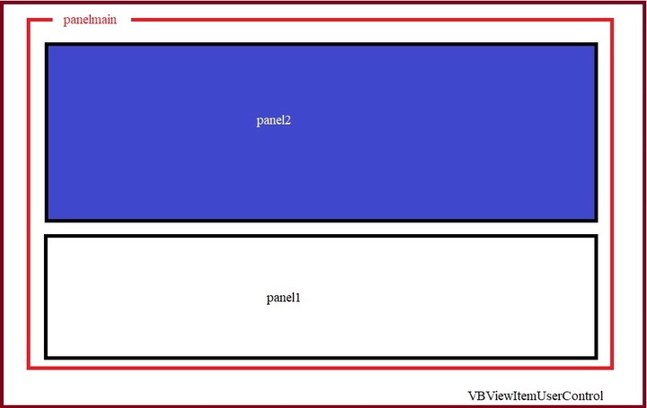

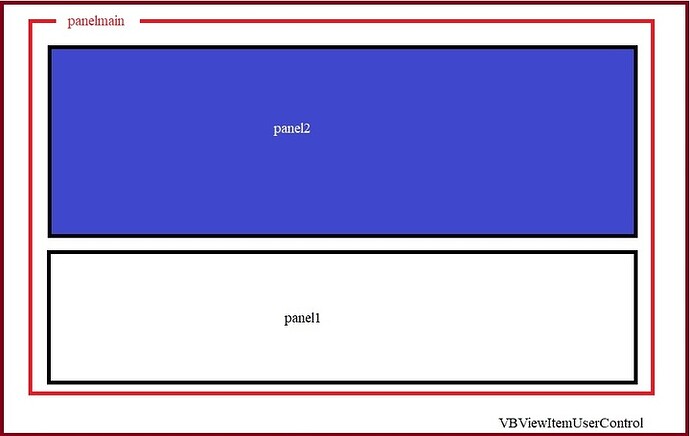

panel2 is above panelmain .. and panel main has 3d borders .. in attachment I put file of my plugin layout .. panel2 has the video.. code is:

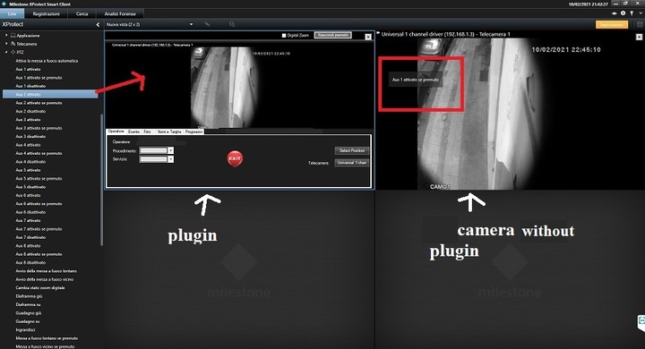

Milestone does not support this functionality as far as we understand it. We are curious about it. You mentioned dragging PTZ preset buttons, can you please explain where these buttons come from? Please add screen captures with the explanation.
ok.. so I explain better.. I get default plugin “VideoPreview”.. I translate plugin in VBnet, with version 2020R1 and I think I had net framework 4.6 (or 4.5)..
After I needed to drag the presets (I attached photos) into my plugin and in the forum, I always read that it could not be possible.. but after many tests, I had succeeded !!! .. even if I put the plugin in the 2x2 screen, I could get the presets in all and 4 screens with my 4 plugin..
then i updated to 2020R3 version and put net framework 4.7, made changes in my project to add functions .. and i realized after a month of changes that the preset, was no longer dragged .. now i don’t remember what i did ..

I remember that the panel had to have a 3d border and maybe I add another class to file ViewItemUserControl..
