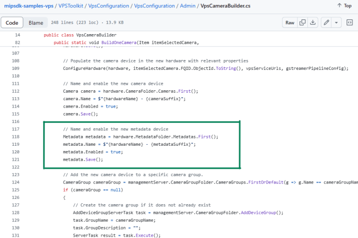

mipsdk-samples-vps/VPSToolkit/VpsConfiguration/VpsConfiguration/Admin/VpsCameraBuilder.cs at main · milestonesys/mipsdk-samples-vps (github.com)

// get an instance of the source camera first, if it’s been deleted this will throw an exception
Camera sourceCamera = new Camera(itemSelectedCamera.FQID);
// Populate the camera device in the new hardware with relevant properties
ConfigureHardware(hardware, itemSelectedCamera.FQID.ObjectId.ToString(), vpsServiceUrls, gstreamerPipelineConfig);
// Name and enable the new metadata device
var metadata = new Metadata(itemSelectedCamera.FQID.ServerId, hardware.MetadataFolder.Metadatas.First().Path.ToString())
 //Metadata metadata = hardware.MetadataFolder.Metadatas.First();
 Name = $"{hardwareName} - {metadataSuffix}",
 Enabled = true
metadata.Save();

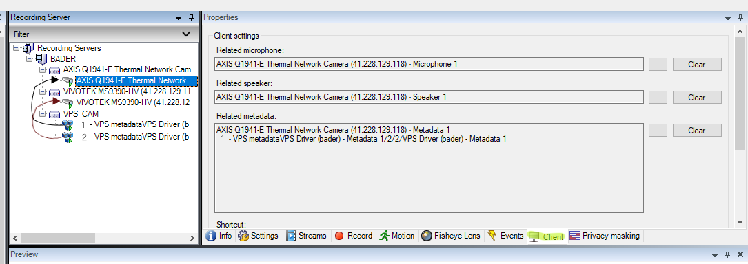

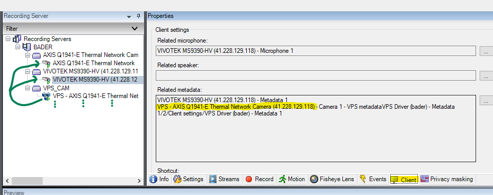

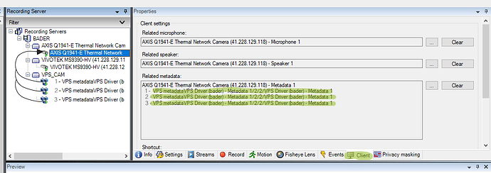

Problem :
Result code with modified
I have a little difficulty getting an overview of this code, but as I read it BuildOneCamera will be called for every camera in itemSelectedCameraGroup passed to BuildCameraForEachChild and that one will add the metadata device as a related metadata to the camera, so the end result will be that the metadata becomes related to all cameras in the group, which seems incorrect.
Again, I am not sure I get this right, but if I do, I think that it is the “foreach (Item cameraItem in cameraItems)” loop at the end of BuildCameraForEachChild that is the issue and BuildOneCamera should instead only be called for the camera corresponding to the metadata.

I am not sure I entirely understand your question as your code to my understand already does that (although maybe not with the mapping you are looking for). I just tested and the following (very similar to yours) works fine for adding all existing metadata devices in the first available group to the list of related devices for the provided camera:
       ManagementServer managementServer = new ManagementServer(EnvironmentManager.Instance.MasterSite.ServerId);
       var clientSetting = camera.ClientSettingsFolder.ClientSettings.FirstOrDefault();
       foreach (var metadata in managementServer.MetadataGroupFolder.MetadataGroups.FirstOrDefault().MetadataFolder.Metadatas)
           if (!string.IsNullOrEmpty(clientSetting.Related))
               clientSetting.Related += ",";
           clientSetting.Related += metadata.Path;
       clientSetting.Save();
