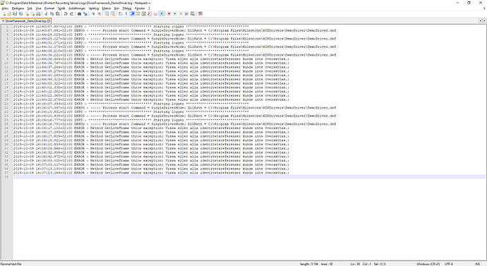

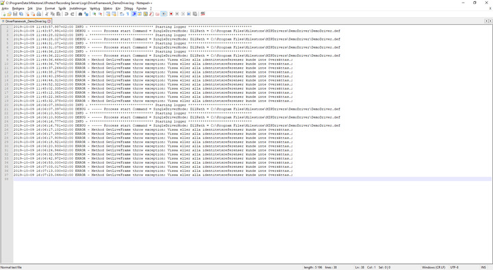

2019-10-09 11:43:57.987+02:00 INFO - ******************************* Starting logger *******************************
2019-10-09 11:43:57.991+02:00 DEBUG - ----- Process start Command = SingleDriverMode; DllPath = C:\Program Files\Milestone\MIPDrivers\DemoDriver\DemoDriver.def
2019-10-09 11:44:28.023+02:00 INFO - ******************************* Starting logger *******************************
2019-10-09 11:44:28.027+02:00 DEBUG - ----- Process start Command = SingleDriverMode; DllPath = C:\Program Files\Milestone\MIPDrivers\DemoDriver\DemoDriver.def
2019-10-09 11:44:31.071+02:00 INFO - ******************************* Starting logger *******************************
2019-10-09 11:44:31.075+02:00 DEBUG - ----- Process start Command = SingleDriverMode; DllPath = C:\Program Files\Milestone\MIPDrivers\DemoDriver\DemoDriver.def
2019-10-09 11:44:36.218+02:00 INFO - ******************************* Starting logger *******************************
2019-10-09 11:44:36.221+02:00 DEBUG - ----- Process start Command = SingleDriverMode; DllPath = C:\Program Files\Milestone\MIPDrivers\DemoDriver\DemoDriver.def
2019-10-09 11:44:36.464+02:00 ERROR - Method GetLiveFrame throw exception: Vissa eller alla identitetsreferenser kunde inte översättas.;
2019-10-09 11:44:36.747+02:00 ERROR - Method GetLiveFrame throw exception: Vissa eller alla identitetsreferenser kunde inte översättas.;
2019-10-09 11:44:37.264+02:00 ERROR - Method GetLiveFrame throw exception: Vissa eller alla identitetsreferenser kunde inte översättas.;
2019-10-09 11:44:38.279+02:00 ERROR - Method GetLiveFrame throw exception: Vissa eller alla identitetsreferenser kunde inte översättas.;
2019-10-09 11:44:40.295+02:00 ERROR - Method GetLiveFrame throw exception: Vissa eller alla identitetsreferenser kunde inte översättas.;
2019-10-09 11:44:44.310+02:00 ERROR - Method GetLiveFrame throw exception: Vissa eller alla identitetsreferenser kunde inte översättas.;
2019-10-09 11:44:52.322+02:00 ERROR - Method GetLiveFrame throw exception: Vissa eller alla identitetsreferenser kunde inte översättas.;
2019-10-09 11:45:02.335+02:00 ERROR - Method GetLiveFrame throw exception: Vissa eller alla identitetsreferenser kunde inte översättas.;
2019-10-09 11:45:12.352+02:00 ERROR - Method GetLiveFrame throw exception: Vissa eller alla identitetsreferenser kunde inte översättas.;
2019-10-09 11:45:22.365+02:00 ERROR - Method GetLiveFrame throw exception: Vissa eller alla identitetsreferenser kunde inte översättas.;
2019-10-09 11:45:32.378+02:00 ERROR - Method GetLiveFrame throw exception: Vissa eller alla identitetsreferenser kunde inte översättas.;

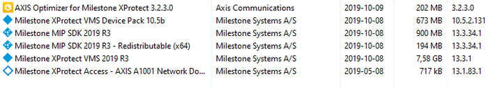

I use the release version, downloaded yesterday around 2pm Scandinavian time.

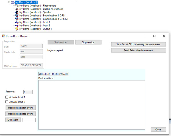

I followed the instructions and managed to add the HW to the Milestone server. See attached images.
