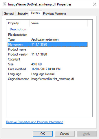

In the error message, the file version mentioned is v10.2.1.2324
But the version I have is 11.1.1.3880
Could this be the cause of the error?
