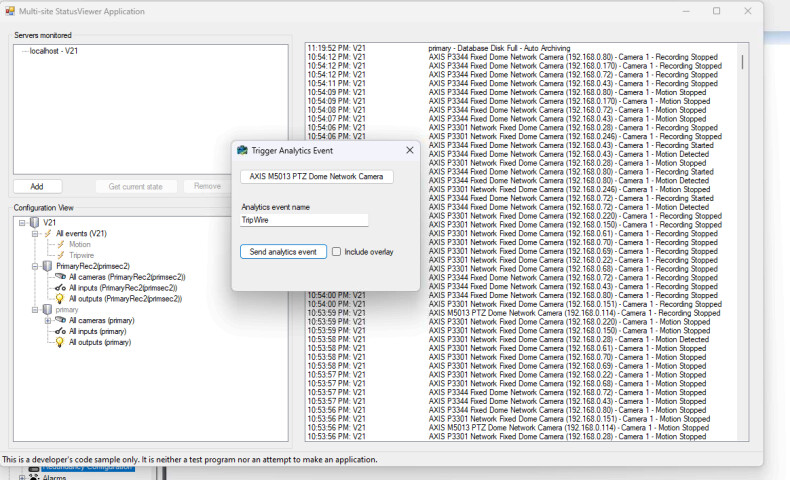

Not getting the event in multisitestatusviewer
Lets try to narrow down the possibilities. It could be that the event is not generated, it could be the multisitestatusviewer not picking up..

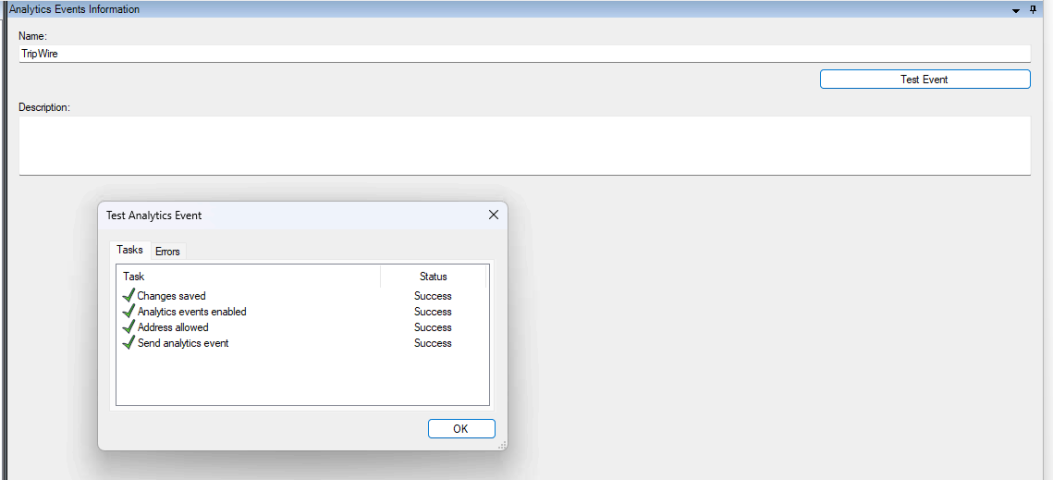

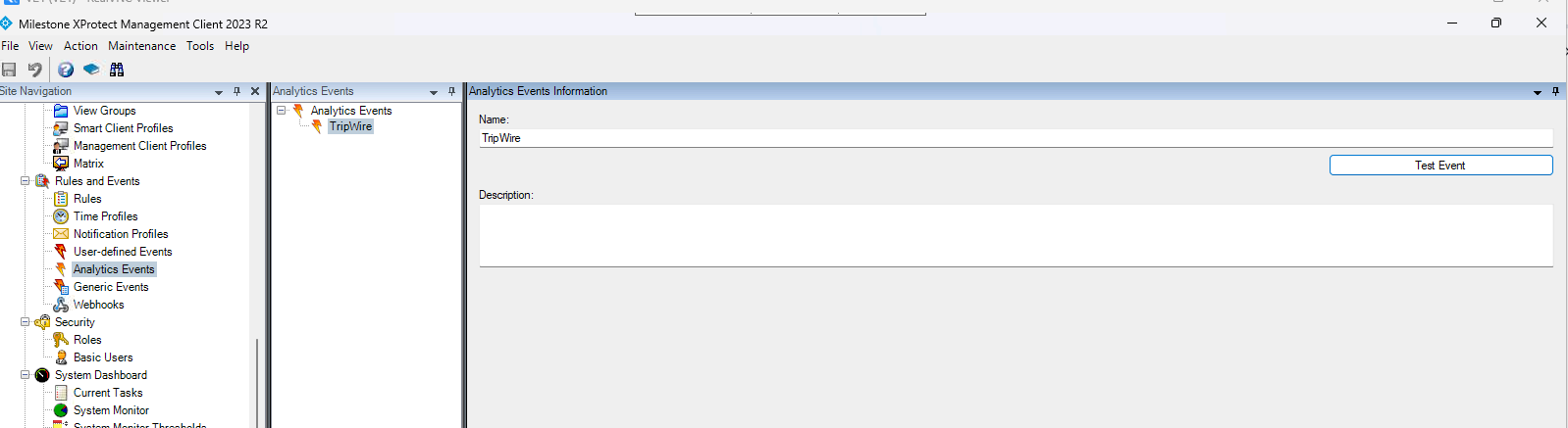

Do you see the event in the multisitestatusviewer if you use the Management Client Test Event?

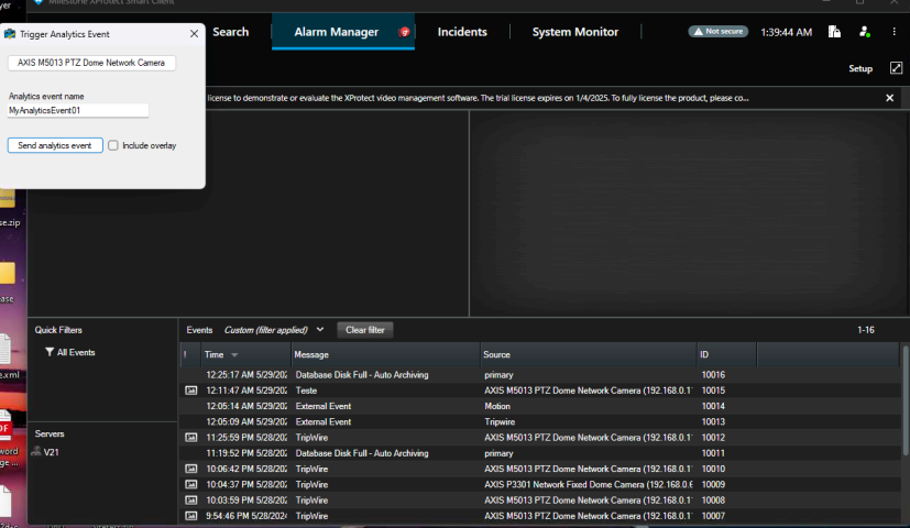

Do you see the event from analytics event trigger if you use it in a rule or if you setup Smart Client to show event?
Do you see the event in the multisitestatusviewer if you use the Management Client Test Event? - Yes
Do you see the event from analytics event trigger if you use it in a rule - No
if you setup Smart Client to show event? - No

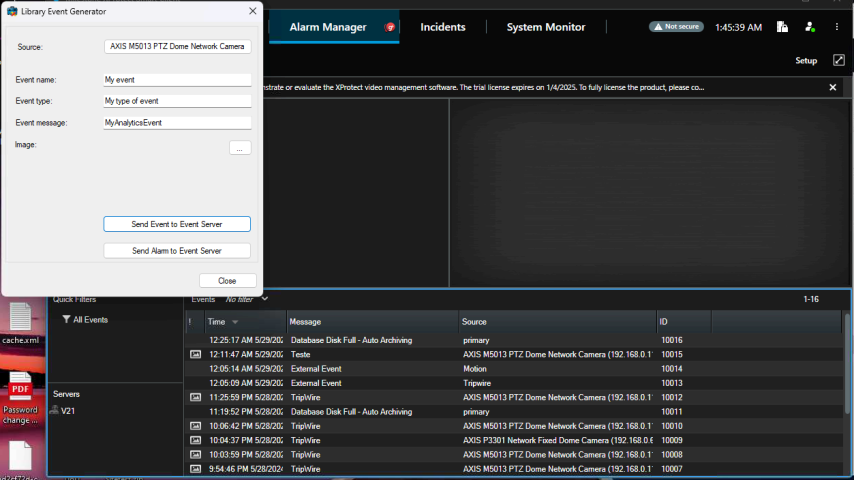

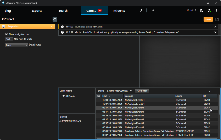

So the suspicion must be that the event is not sent and properly received. I would like you to test in the Smart Client like this: In the Smart Client on the Alarm Manager tab go into setup, pick the Alarm List, change it from Alarm to Event,

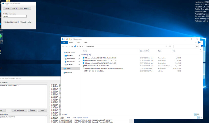

not getting events
using XProtect Corporate 2023 R2
using latest samples taken from github
even from other app not getting events

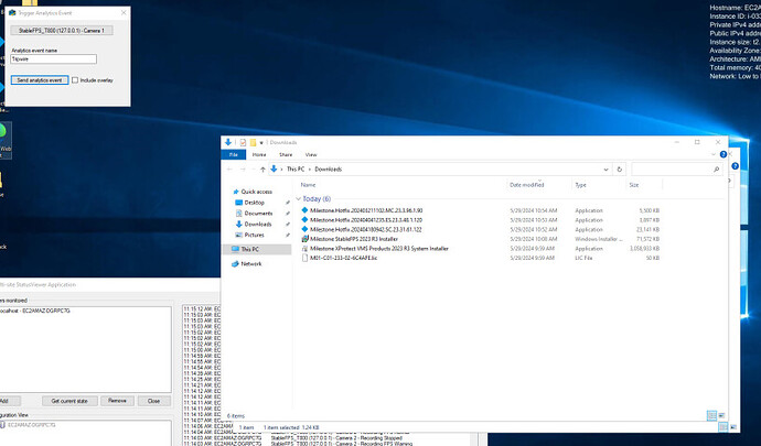

Did a fresh install of corporate 2023 R3 with all hotfix applied , still getting error
applied all listed patch(SC,MC and event server), still getting Alarm list returns error — ‘An error occurred when verifying security for the message.’ (troubleshooting) (milestonesys.com)
