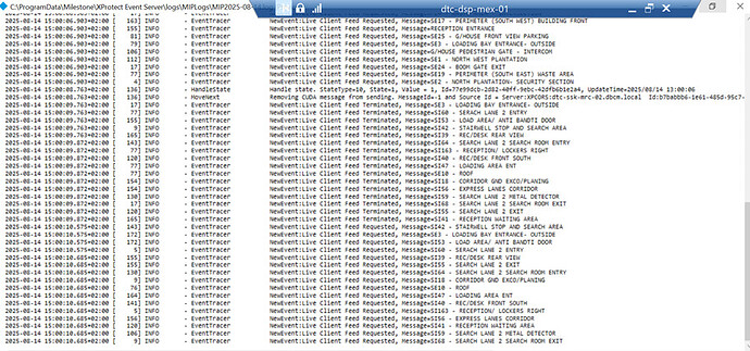

In the screenshot below this with the logger set to “info” you will see that every event even from operators is being logged, this includes motion stop start, recording stop start etc.
When we trigger an event via our application into the plugin via RabbitMQ, the logger shows it received the event with the exact same time stamp as our application transmitted the event to our plugin. However, Milestone seems to only process the event about 5 to 10 seconds later. For instance, the received event should start a specific rule.
This is the same case when we set the logger to show only “error”. The logger then does not show all the events but the processing of the events is still the same delay.

The server has the EventTracer sample plugin deployed and running. I suggest you remove it.

Hi Bo, Thank you so much for your support. We did trace the problem to one of our item managers. We actually only intend to listen for audio events. It was tracing all events.
