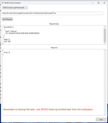

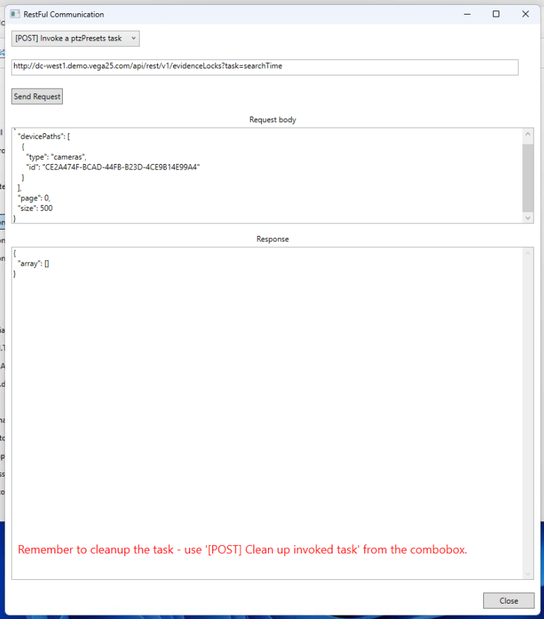

trying this
http://vmsaddress/api/rest/v1/evidenceLocks?task=searchTime
body
“devicePaths”: [
“type”: “cameras”,
“id”: “CE2A474F-BCAD-44FB-B23D-4CE9B14E99A4”
“page”: 0,
“size”: 500
always getting an empty array
We have evidence lock for the camera and can get using SDK’s MarkedDataSearch but not with API.
Are we missing anything?
Thanks,
Vega
Working with this we have now discovered a bug.
What we found is that the “size” must be in the URI.
So this works..
POST /api/rest/v1/evidenceLocks/?task=searchTime&size=500
and works with the same body as you have.
For now I hope you can use this workaround.
