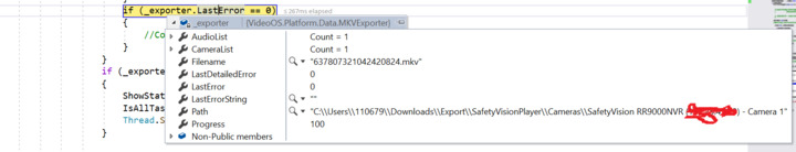

We have developed one Smart Client Plugin and we are implementing Recording export into MKV format (we took reference of “SCExport” plugin from “mipsdk-samples-plugin”). We are able to export the recording data but we are facing few problems.
  • When we call the start “StartExport” function, it will also export progress bar on Smart Client but we don’t want to display progress bar on Smart Client. we would like to manage progress information in our plugin
  • We would like to export that into specific path when data export it is adding additional folders inside selected folder. It is adding additonal folder “DateTime → Media Player Format → Camera Name”
  • Even Recording data is not available exporter return Success but Smart Client Status display failed
