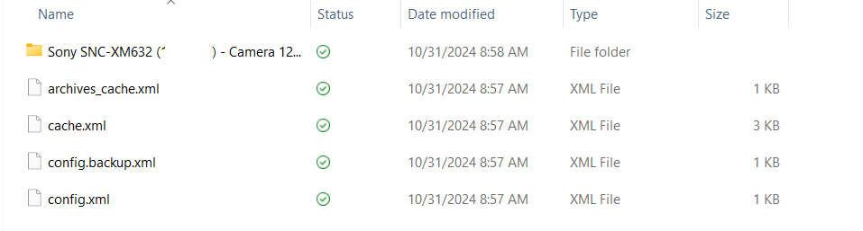

In MIP SDK I exported only the camera files (I attached the picture last comment).
I attached a picture of 3 files.
Please export from Smart Client and make your observations..
It is not good,
because the MIP SDK—Export Sample exports the files without the CSP file and other files.
I can’t run the files I exported from MIP SDK—Export Sample with the Player or Client that you suggested.

I have one problem: When I export from the MIP SDK—Export Sample, the CSP file doesn’t export.
I attached a photo of the files I exported from MIP SDK—Export Sample.
Please review the photo “MIP Sample” and tell me what to change to export the CSP file from MIP SDK—Export Sample

Something is amiss. Can you please verify that you have the same sample? -
https://github.com/milestonesys
Maybe you have mistake found something that isn’t the sample or a very, very old version?
Please at the same time verify that you are using the newest NuGet building this.
https://www.nuget.org/profiles/milestonesys
Also I have a Project.SCP file, not a CSP file. Not sure what that might be.. Typo perhaps?

It is work!
I learned I must have SC on the computer to export with the Project.SCP in the export sample.
